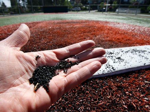

These crumbs are used as filler between blades of artificial grass.<span style="color: Red;">*</span>(Photo: Elaine Thompson, AP)

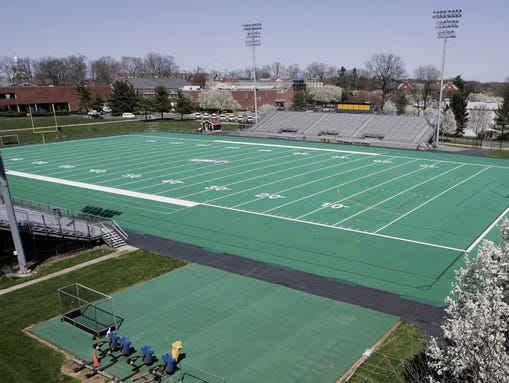

An empty Lions Stadium in April 2008 at The College of New Jersey following tests of artificial turf that turned up unsafe levels of lead.<span style="color: Red;">*</span>(Photo: Mel Evans, AP)

Artificial turf at a Nevada day care had 8,800 ppm of lead — 22 times the federal soil hazard level, according to a 2010 study led by a scientist at the federal Agency for Toxic Substances and Disease Registry. In 2008, New Jersey health officials found lead levels eight to 10 times the federal level in both school athletic fields and in turf marketed for residential use.
Turf-and-rubber fields typically contain about 200,000 pounds of rubber crumbs, made from thousands of former car and truck tires that may have varying levels of hazardous substances. A single field can have "substantial variability" in its materials and in the "concentrations of contaminants," the EPA wrote in a 2009 study, listing 32 potential contaminants including arsenic, benzene, mercury and toluene.
"You pick up rubber off a field and you don't know what that piece of rubber came from," said health advocate David Brown, Connecticut's former head of environmental epidemiology and occupational health. "It's not a manufactured item. It's a waste. There isn't quality control."
